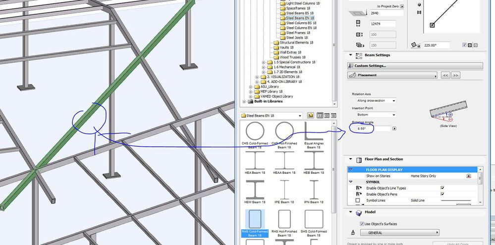

hi all
is there any chance to change the angle of the steel beam profile object by construction and not by editing the angle field in the property of the object?
thx for help!
rdgs, Florian

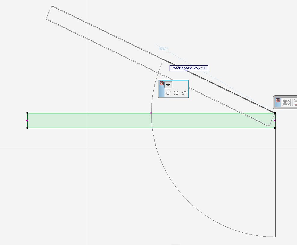

You can rotate it in 3D and section/elevation using the middle hotspot. You can set if it is at top, middle or bottom in the object settings.
Only downside is, you can not rotate it this way, if you rotated the profile along its own axis.

hi Erwin!
perfect - its working! thank you!
