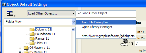

There is another way to manage library parts you might like better.
You don't have to load any libraries at all. You can get them via the Load other Objects...From Dialog Box.
The idea is to create a folder with all of the ArchiCAD library parts in it and choose only the part you want from this folder, rather than always loading everything in the entire library just so you can get to the stuff you need.
There are several advantages to this, and a few drawbacks as well, as I am sure you will read about when the orthodox guru's see this and want to set you straight about it.
Here is how it goes:
Open your ArchiCAD 11 Template.tpl
Don't do anything to it, just save it as a .pla somewhere you can find it.
In the pop-up, be sure to include All Parts of Loaded Libraries.
Next open that .pla you just made.
The Open Archive window will open.
Select Extract Elements to a folder.
It will make a folder with all of the library parts in it.
Now you can just get the part you want via the From Dialog Box.
Now you have a folder with all of the library parts as separate files that you can use your windows explorer to search, sort, sync, ect...and you can use the Thumbnails feature to see each of them in a nice big window.
There is one more thing I would recommend.
When you get you Template configured the way you want it, make an .pla file of it just like above, but this time, save only the parts used in this Master Template. Use this as your default library so you will always load a basic library that has what you need as far as graphic symbols, lines, fills, section markers, and a few things like that which you need for all projects.
Also learn to use Favorites.

Steve Jepson
~/archiben,
You can not explore an .lfc file to see what is in it.
The entire purpose of what I have explained is how to get the Library parts into files where they can viewed and managed with the Windows Explorer.
What is your objection to showing someone how to do this?
andryro has used this same principle to do exactly as I have, create a folder based Library, and for the same reasons.
The current way ArchiCAD is intended to manage Libraries is not great.
It needs some imporvemnets.
If you don't like the idea, don't do it.
Your explanation of creating a .lfc file is absolutly useless for this purpose.

Steve Jepson
The extract a container command generates a .lfc file right?
How is that useful in doing this?
If you can explain it better using ArchiCAD 11 steps that would be great.
Post it.
I am describing a very old process that has been used for many years.
