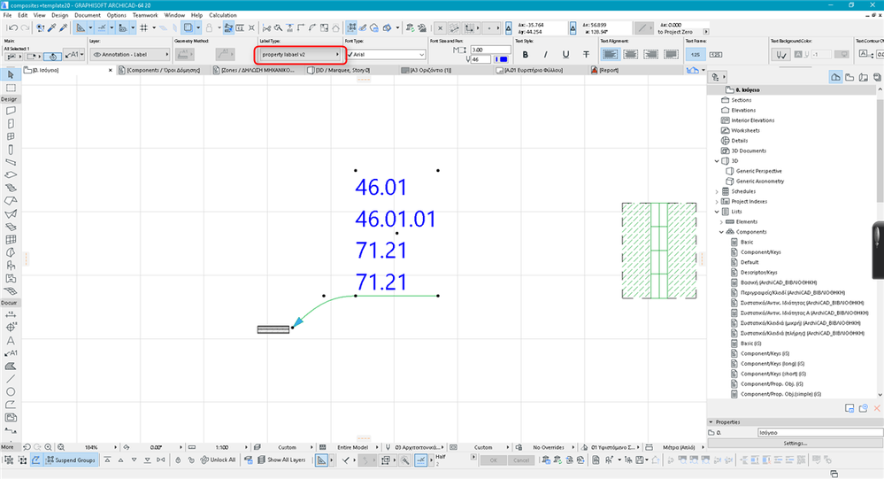

I used the example in gdl guide on REQUEST ASSOCEL_PROPERTIES
I used the command in the 2D script not in parameter or master script
To make an example I used a composite wall and its associated property object.
The property object has many components that retrieve information from different databases.
The resulting label is alittle bit odd.
It retrieves the key codes from the property object from components of both of the databases that is use, but not all of them.
furthermore I would like to ask how I could limit my results to the key codes of the components of a certain database? I don't understand clearly how the matrix stores data and if I should use one or two dimensinal array and how to retrieve certain information.

I'm trying to refine the associated property object label I posted earlier in this thread. I'm trying to use the values retrieved as drop down lists to filter information. I use command : values "___dbsetname" _dbsetname
_dbsetname is an array that holds the names of the databases that provide info to the property object. Is this a problem of the request ASSOCEL_PROPERTIES? can the values retrieved in array be used for parameter values.
P.S. in the array there are common records is this a problem? should I make a new array that holds descrete values?
Thanks Ioannis
Thanks Ioannis

ispyridis wrote:it seems my problem is that the array has duplicate values. is there a way to make an array with unique values out of the initial one?
Thanks Ioannis
Thanks

I managed to limt the _dbsetname values to a new array __dbsetname my problem now is that a zero "0" value comes from nowhere. below is the code with some text2 commands to test contents of both arrays. in the attached image you can see the zero phantom value. Can anybody help?
n=0 nnn = REQUEST ("ASSOCEL_PROPERTIES", "iscomp,dbsetname,keycode,keyname,code,name,fullname,quantity,totquantity,unitname,unitformatstr,propobjname", n, DATA) if n = 0 THEN TEXT2 0, 0, "No properties" ELSE j = 0 k=1 FOR i=1 TO n IF i/1 = 1 or (i-1)/12 = int((i-1)/12) THEN _iscomp= data k=k+1 ENDIF NEXT i k=1 FOR i=1 TO n IF i/2 = 1 or (i-2)/12 = int((i-2)/12) THEN _dbsetname = data text2 15,k,_dbsetname k=k+1 ENDIF NEXT i k=2 __dbsetname[1] = _dbsetname[1] text2 0,0, __dbsetname[1] FOR i=2 to VARDIM1 (_dbsetname) IF _dbsetname = _dbsetname[i-1] then k=k else k=k+1 __dbsetname = _dbsetname ENDIF NEXT i for i=1 to vardim1 (__dbsetname) text2 5,i, __dbsetname next i text2 10,5,vardim1 (__dbsetname) text2 10,2,vardim1 (_dbsetname) ! ! ! VALUES "___DBSETNAME" __dbsetname, CUSTOM !

ok I found my mistake in the code
k=k+1
had to be after
the problem now is that even though I have an array with unique values, I cannot use it in a value list. What is the problem?
k=k+1
had to be after
__dbsetname
