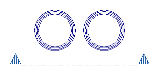

One of my designers has a large column he built using the Profiler. It looks decent in plan (not exactly right) and 3D, but at certain rotation angles it leaves out certain lines. The attached graphic shows two colums and a section marker in floor plan. The column on left is rotated at 0 degrees, and the right one is rotated at 90 degrees. The graphic in the next post shows the result in the section window -- the left column is missing several lines.
Is there a way to fix this? He has rebuilt it several times, so there is either something wrong with the was ArchiCAD wrote the GDL, or we have another bug.

The elevation.
I had this happen several times before. It seems to be a bug. The solution is to rotate the profile on it's axis by a small angle so that it does not align with the elevation.
