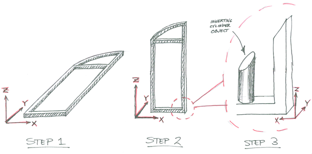

I’ve created many objects already and I did what you have suggested (changing the z to 90). What I’m looking for is the ability to rotate elements about the x-axis without having to mess with the 3d projection settings.
Refer to my diagram please:
Step 1 construct the outer part using a mesh.
Step 2 rotate about the X axis
Step 3 enabling me to insert a cylindrical object to create the bars.
By figuring out how to rotate about the X and Y-axis I would be able to tilt up any object creation off of the ground level. So far all I can do is rotate about the z-axis.
One possibility would be to follow the old method used by AutoCAD, if I was to construct this in AutoCAD I would reset my xyz coordinates so that I would be working in an X and Z plan instead of an X and Y Plan
...if I was to construct this in AutoCAD I would reset my xyz coordinates so that I would be working in an X and Z plan instead of an X and Y Plan
I'm sorry to tell you there's no rotation about an arbitrary axis in AC. We don't have that kind of coordinate system flexibility.
The object 'Cylinder' 10 in 13 Special Construction / Basic Shapes can have any angle relative to the XY plane. Helps?

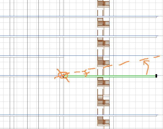

Hi, I think I have a similar problem. I'm in elevation, and I'd like to rotate a floor slab for an auditorium space. Unfortunately, most of the move/reshape options are greyed out. I'm new, I'm sure there's a simple solution.
See attached photo
Thanks!
Hello,
Have you tried the roof tool instead of a slab?
Erich
As juha says, you must use the roof tool. The slab tool does not have the ability to slope.
Erich
