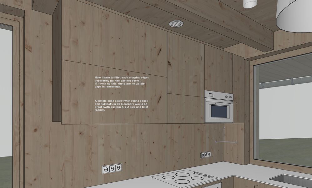

Hi, I've got a kind of suggestion or question. It would be really great if Archicad had a better round edge feature. I know that you can fillet / chamfer morph edges and that's ok, but you can only do it for one morph at a time (even when they're grouped). Round edges are really important in renderings (I'm using D5 render directly with Archicad) when it comes to furniture or other interior detailed geometry. For example - now if I want to fillet edges of all my kitchen cabinet doors, I have to go one by one and perform this action for each separate cabinet door. Also, this can mess up my existing dimensions. Adding new ones is also challenging when you have to click percisely on the morph's edge, not the neighboring round edge, which is usually about 3mm away.
I've got one solution in mind, but I don't know how to make it myself. I'm imagining an object, which is a plain cube with round edges. You can define the cubes X Y Z size and edge fillet radius. But the object only has hotspots where you need them, which helps with placing dimensions and keeping them in place.
Does anybody know if such an object already exists or be so kind to create it? For future versions of Archicad it would be great to implement this. Especially when you don't really have to use any other software than Archicad and your rendering program these days.
Adding an image to describe the problem a bit better.

cuba
Round edges in archicad makes to much geometry.
It is enough to have a small space between the cabinet doors to take advantage of the rounded corners feature of the rendering engine:
https://www.d5render.com/post/create-exquisite-materials-with-round-corner-in-d5-render

hajnyma
Thanks, I know this feature in D5. I consider it really "messy" to make small gaps between geometry. Also, round corners in D5 are "fake" and sometimes you can spot it.

cuba
Something like this?  Better build a cabinet around it with a gap between two fronts for more realism....

That would be much easier as an HPRISM command in GDL.
Then just ROT it to stand it up.
cuba
That's true but if you want to render this, you may want to give each plane a different material and that doesn't work as well the hprism.
This is of no use to you when you are creating 2drawings but can be useful when rendering.

hajnyma
Thanks cuba, that's exactly what I had in mind! Is there any way to set a custom texture origin as if it was a morph? If I had that, all my problems would be solved 🙂

hajnyma
I think this is really helpful for custom furniture. I guess for many people it's much easier to create furniture out of separate panels, not the predefined cabinet objects. Especially architects like me who don't really need the inside of the cabinet, just the outer shell.
To make it perfect, it would be great to add:
- Custom texture origin.
- Fillet / chamfer switch.
- Outlines on the box edges only (there would still be the geometry, but you wouldn't be able to see the round edge outline, just the main box edges.
Thanks so much
