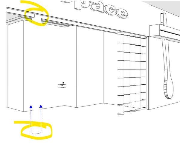

I have some round columns who's edges seem to not show on 3D.
The column is there, but the edges seem to be white.

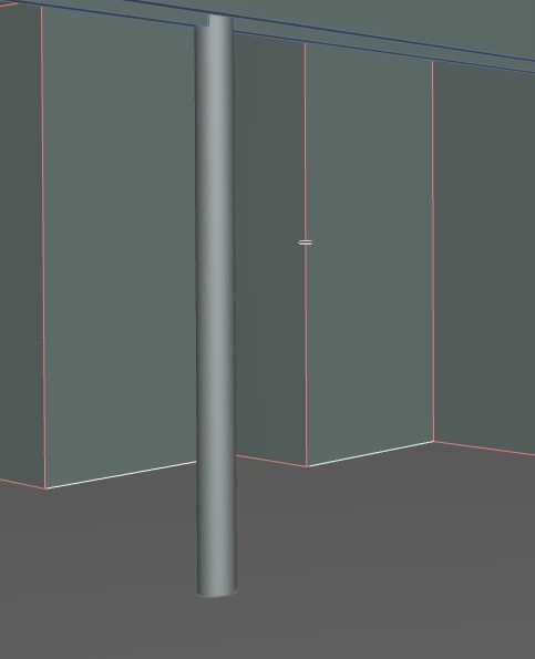

This visibility is set to "White Model", but when I change it to "simple shading" the column is clearly visible.
Does anybody know how I can change this to be visible in "white model"?

You might need to change your contour settings...
See this... 3D Styles

This is sadly a weird limitation with the OpenGL engine in Archicad. I mourn every time I see this.
I hope this will be fixed at any point in the future.
