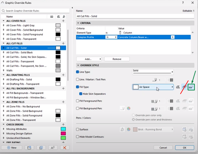

I have a complex profile column with multiple building materials. When the column is cut, the layers are correctly shown. But when the column is not cut (is to be projected - e.g at a roof plan) the lines seperating the building materials are still shown. I would like only the outline of the column to be shown when it is not cut (just like a composite wall element).

Hi @Ancha,
To achieve this result you can use GO ( Graphic Override ) rule specific for this column and use it when you need, watch this video.
https://youtu.be/4Nyi1_IX3wo

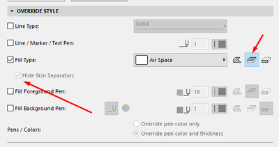

I tried this but apparently the "Hide skin separators" option works only for the cut views of the element - the option is not available for projected view:
So it is not possible by this way to have only the projected view solid white without skin seperators - it is working only as a global rule that is not the case here (I have the same complex profile elements projected and cut in the same time in the floor plans).
Is there any other way?
Or am I stuck with modeling a thin plaster slab element on top of the columns that are free standing - this sounds reasonable but since the wall composite serves a solution I was wondering why the complex profile is not.
