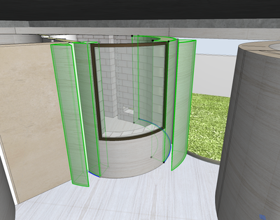

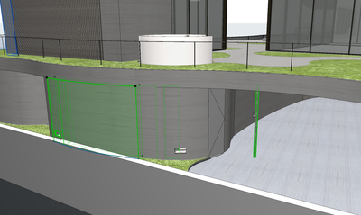

Curved walls misbehave in 3D (while 2D is ok)
Anyone knows why the walls would behave like this in 3D?
The plan is OK, no problems there. Just the 3D. We have a blobby project and this is happening all over it.
Changing the curvatures of these walls sometimes help. But we don't want to change all the plans.
Thanks!

How far is your model from the Project Origin?
If it is a long way, this can cause problems.

All the walls are curved and of the same composite so its can't be that.
If I change these curves it will connect better, seems to be a problem only when the curve isn't smooth. But we can't change the curves.
