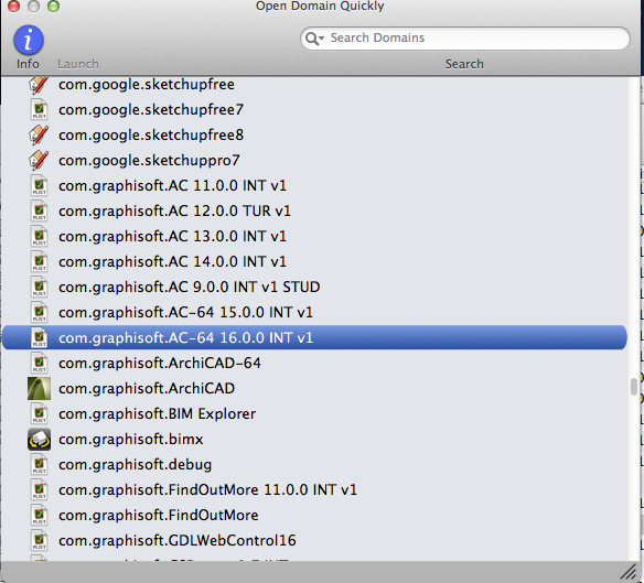

Thanks Katalin,
I am using a mac. After installing pref setter and using terminal to see all the library parts, I reached an 'open domain quickly' window and that's where I stay. Can't seem to reach the registry editor.
The only reason I actually need the uneditable option is not only because it is small in size, but one can edit the 2D presentation and make it look as one desires.
Anyway. Do you have any suggestions on how I can reach this registry editor?
Just forgot to include the window.
Hello,
In Mac the preferences file is located at;
user/library/Preferences/com.graphisoft.AC-64 16.0.0 INT xx.plist
and you can open it with Pref Setter from there.
Alternatively scroll down the Pref Setter's "Open Domain Quickly"-window to find the
"com.graphisoft.AC-64 16.0.0 INT xx.plist" and open it with double clicking.
However the mentioned setting LibPartEnableSaveBinary could
not be found - at least in my Mac. It is possible to add the key with Pref Setter as
shown in the pics.
Hope it works.
