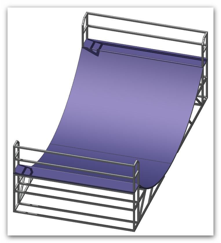

I have found "half pipe skate piste" object:
And the object :

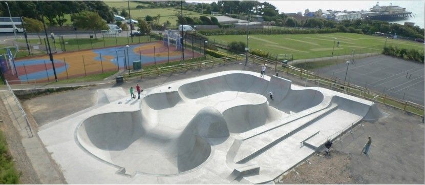

Use SLAB for the base plate, then use basic shapes (sphere, cone, cylinder...) with SEO to form curves...
And don´t forget the new SHELL tool in AC15!

Scotch wrote:
/....... but what is SEO. /......
Solid Element Operation see attached pic.........
PM ....... and I'd be pleased to assist in person.
