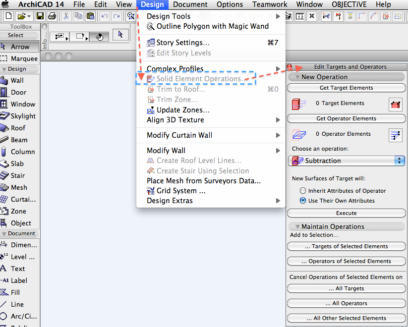

Thanks for this tip but what is SEO. We are also only using ArchiCad 14 at present.

Rod Jurich
Scotch wrote:
/....... but what is SEO. /......
Solid Element Operation see attached pic.........
PM ....... and I'd be pleased to assist in person.
