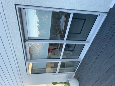

2026-05-28 06:16 AM
How does that slide inside of the awning window?
Wouldn't that hit the winder mechanism?
I would check with your window manufacturer that that is even possible.
I am not saying it is not, but I have never seen this.

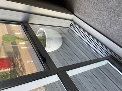

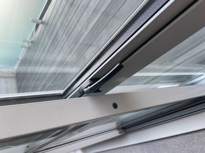

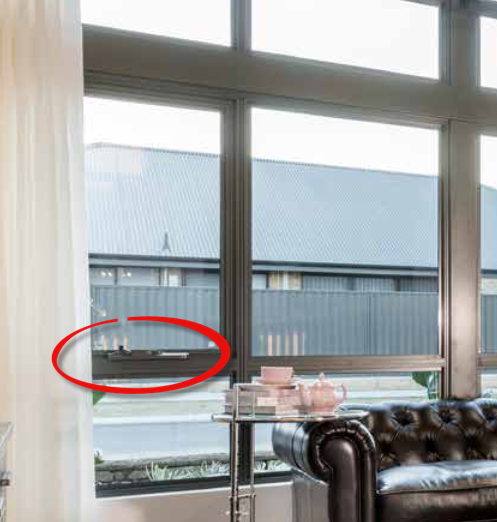

Hi Barry, most joinery manufacturers offer this set up in New Zealand. It allows for ventilation when the sliding door is shut if there are no other windows in the room. The frames are deep enough to offset the sliders from the handles of the awning window. Here's some pictures of the one our office:

Ah, just a push out awning.
I am used to awning windows with winding mechanisms mounted to the sill.
These would get in the way.
