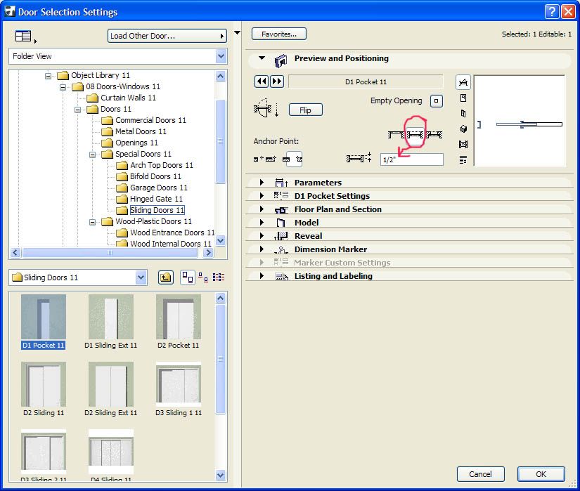

I'm using an interior sliding door for a bathroom entry. Is there a way that I can show it without being attached to either the left or right side just in the middle?

If you set the contruction method type from EDGE to SILL then you can set the set back dimension so the door sits in the middle of the wall.
