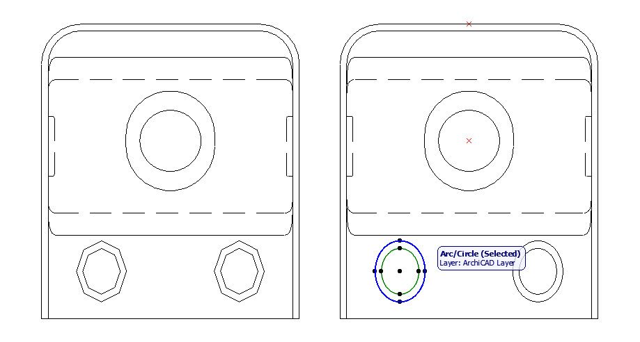

I have forgotten how to make objects have smoother curves.
On the left is the object. On the right are the original lines and curves.
What can I do to make the curves smoother when making objects ?

quick fix is to split the circles so they are arcs. Then it will be smooth as shown on the right.
I am looking for a better way than this kind of work-around.
use the RESOL or TOLER command
Steve Jepson
Thanks. That works!
