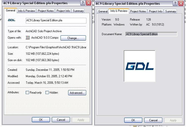

Kind of a New question, but what is the latest SE Library? With PC, I have selected the Properties of the SE PLA file (See Attached). This PLA extracted from a download of "AC9 Library Special Edition.zip" that I downloaded on Nov. 4, 2005. The Extracted files seem to have been created on Oct. 3, 2005 and the PLA has a Written By: AC 9.0(1812).
Is this the Latest US AC SE 9 Library?
No worries now. The update solved the issue (but I had a bit of hassle to find some missing objects in my master template).
Jay... did you check the dates here?:
http://www.graphisoft.com/support/archicad/downloads/library_updates/usaSEdownload.html
