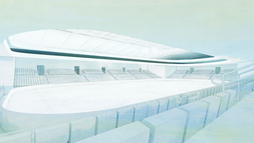

I've used it before for a mockup, see below.
The curved option is a bit fiddly, though, if you are looking for curved seating. You can get decent results, but need to place more than one instance of the object once the seats start spacing out too much. You can only set a fixed number of chairs per row, so after 5 or 6 rows the spacing becomes too big.

Thank you guys for your help, special thanks for Erwin. This is a great object and I'm really pleased with the result and the amount of time it took me to achieve it.
