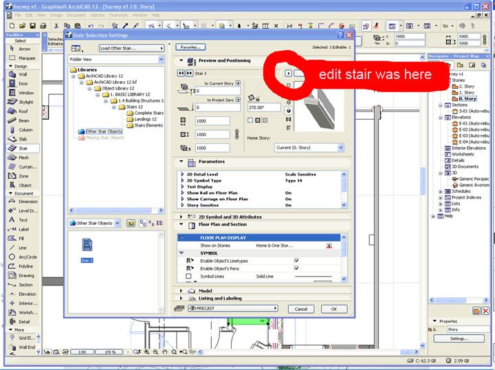

BryanRichards wrote:Select the stair, open the stair tool settings dialog, click the Edit Stair button. The obscure small arrow is gone, I dare say Good Riddance!
In archicad 12 the option for editing a stair which you have created has moved from its spot in AC11.
In 11 next to the create stair button within the Stair Selection Settings there was a small arrow that looks like a play button. When selecting the stair you have made and clicking into its settings, an edit this stair option was available under this play button.
Where is it now? or how do i edit a stair thats been previously made in Stair Maker.
Thanks
Bry
