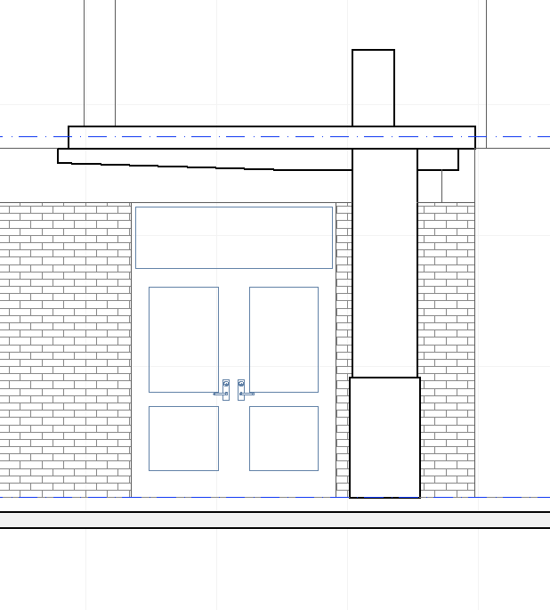

It just keeps getting worse with these storefront doors. After placing about 20 different types of storefront doors in our model, I pulled up a few exterior elevations and noticed none of the frames were showing up in elevation.
I have tried changing as many settings as possible to get the frames to show up, and nothing happens.

Rod Jurich
rm wrote:
/.....I have tried changing as many settings as possible to get the frames to show up, and nothing happens. /..
If you haven't already, try setting different materials for the frame and leaf.
Unfortunately it will not solve the line missing between the leaves.
In our parts, I've had to add the line in the 3D script.
Rod Jurich
