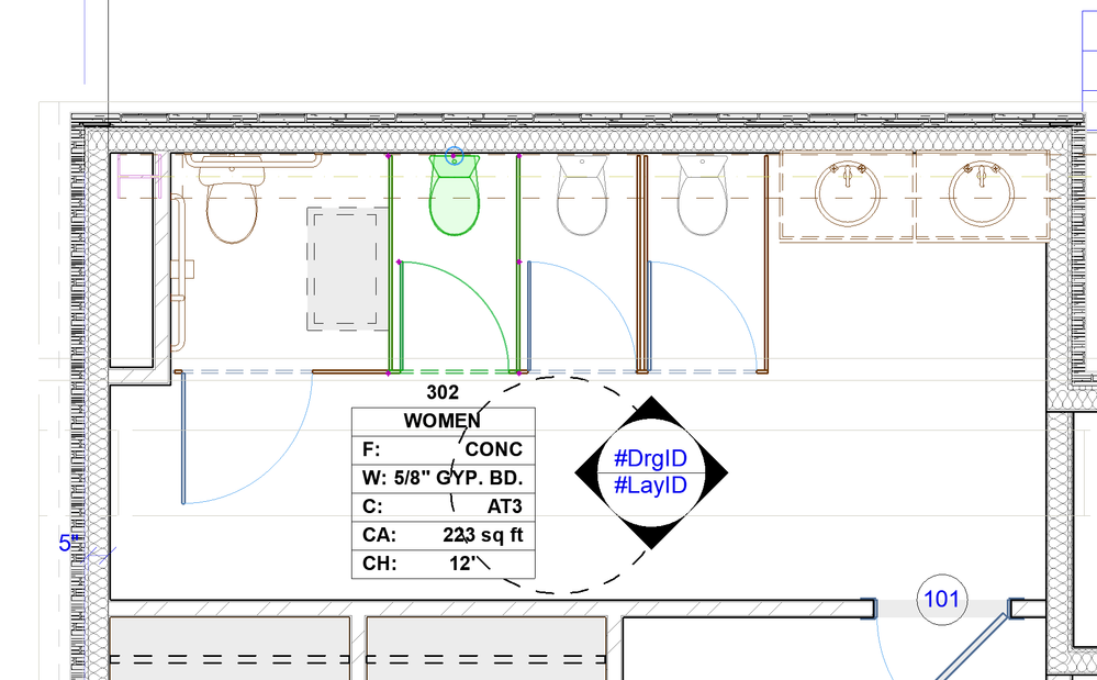

I have placed toilets and stalls with A25 utilities
The toilets in the stalls show on the plan but not in sections or 3d.

Check your renovation status for the WC elements and the display settings.
If the WC's are part of the cubicle then maybe they are controlled in the object display settings e.g. an option to "Show in 3D"?
David Maudlin
Rockstar
He is correct. look at Object Settings > Commercial Bath Stall Settings > Fixture Settings... > "Fixture in 3D" check box.
