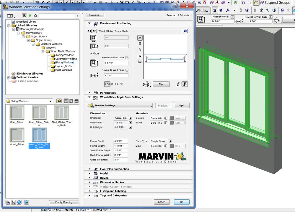

You can try some of these Marvin window too. Anderson, Pella, and others.
http://www.marvin.com/windows/magnum-double-hung-windows/sizes-performance-and-specs/
