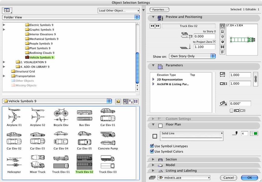

Truck 032 symbol - much to wide
The truck 02 in the Site symbols is 12'4" wide
This is impossible
Who is the ***** generating these symbols
The way I read to change this would be a snap with Revit but not in AC because there is no width adjustment option, one needs to create a new object, for a novice is not a simple task.
As I have expressed AC is as good as the objects is coming with and this is execrable as this example point out

Yes, I've noticed that also. Truck 01 is the same width (3.824 m!) Probably the lengths are also overdimensioned proportionally (truck 01 is more than 17 m!). And they can't be rescaled, unless you change the scripts.

I'm using the regular Library. Actually I've made a mistake in the previous post. The truck which is 17.324 m long is 'Truck Elev 02'. Anyway, the widths are the same for 'Truck Elev 01' and 'Truck Elev 02': 3.824 m, i.e., 12.54 feet (see attachment).

Yes, Truck 02, the one showed in the picture. As you can see, it is 3.824 m wide, or 12.54'.
I just did not understand why your Truck 02 is different from mine.
But the main question is: what is the CORRECT dimension for a truck like that?? I'm working on a Distribution Center, and the preliminary dimensioning depends a lot on this truck's size...

the correct dimension of such a truck is about 2,50m (width), but measured without exterior mirrors etc.
you should open the library part, correct it and save under a new name.

Thanks, Gerd, that was what I did.
Put a MUL2 A, B at the beginning of the 2d script. Then set default value of 0.78 to A and B.
