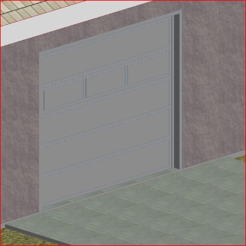

I have latest US library......I just noticed that for some reason I cant get this particular door leaf to show the glazing. It's all one common material. I tried every setting possible to make the glazing show.
Ideas?

Not that this solves your problem, but I don;t think that the leaf style you are using has a glass surface defined. If you try switching to a different panel, such as style 5 in the same door, the glass appears.
I am sure someone more versed in AC than myself can direct you to a solution.
