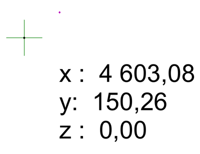

Can someone tell me how I can get the coordinates object to show UTM coordinates?

Do you are talking about this ?
Or this ?

Hello Christophe, and thanks so much for your reply.
I mean the lower one (coordinate object). I want it to show UTM-coordinates when i place it on my plan.

Have you tried using the "Location Reference Point" object ?
You are able to make the north direction invisible and get the X, Y, Z dimensions.

I found the solution: Survey Point object.
