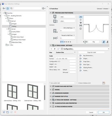

So, my problem seems to be unrelated to other solutions I've seen on this forum, but happy to be redirected as I'm hoping this is something simple. Essentially the issue I'm having is that the basic editing tools that allow you to drag the door to a custom within plan (using the purple editing point), makes no actual change to the door size.
I've gone through and ensured the door is set to custom sizing and tried to find any other related issues with the base setting, however, this currently just seems to be a glitch. I can only edit the door sizes currently via the egress size. attempting to change the overall width will simply see it revert back and ignore the change on clicking ok.
In the second image above, I have tried adjusting via the options in the top ribbon which just instantly reverts back and dragging the purple editing point, with the correct settings. I've then gone into the regular settings and tried the overall width, which is ignored, and so can only change with egress width in the later editing panel options.
Is this a setting that I have wrong somewhere, or is there another way to bypass this? Incredibly frustrating to have to change everything based on manual measurements.
N.B. this is the only file I have this problem on.

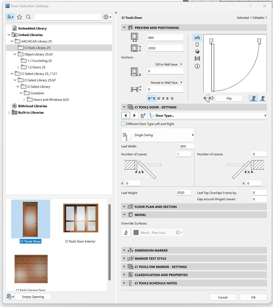

james1994
@Lingwisyer It's not so much a toggle as an input, I've attached an image of it. It's entirely possible however, the door in question are presets used by the firm I work for. The bit that doesn't make sense is that it's only this file that's locking them.
For the image, the input for leaf width was replaced by egress width in the file I was using, so perhaps you're right and someone's accidentally changed the coding.
