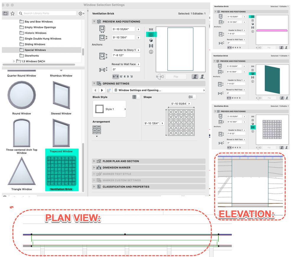

I placed a group of breeze blocks using the ventilation brick in the windows tool but the model and section views don't work, attached is a screen shot of how its set and what I see once placed. It's usually some simple setting or button I've failed to click but I'll spends days or weeks trying to figure it out.
Any idea how to fix?

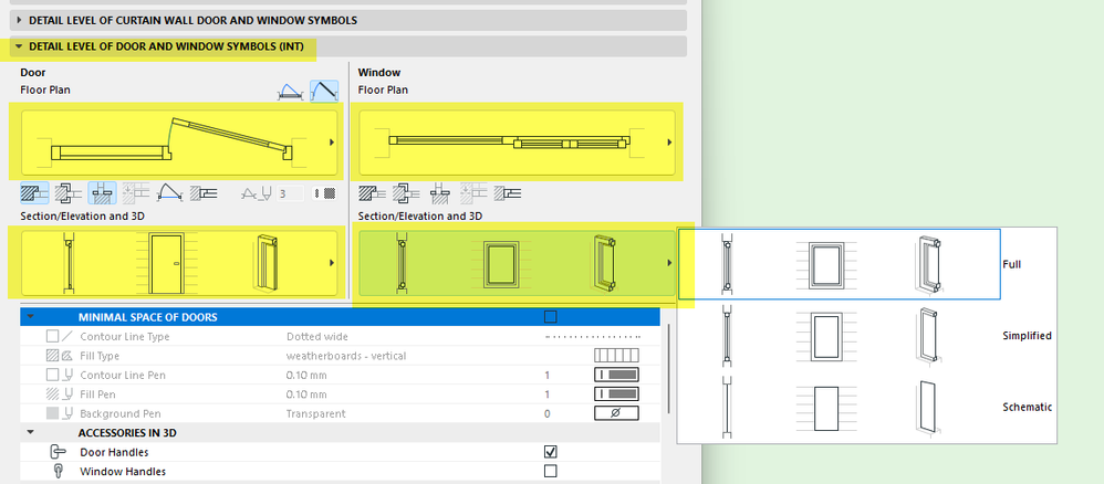

Have a look in your Model View Options at the Detail Level for Doors & Windows.
Set the plan and 3D options to FULL.
I have no idea why they are set to symbolic as default.

You can also change it locally if you do not want to change the detail of the rest of your windows

What version of Archicad is that?
I think this option was taken away in 28/29.
It now only exists in the MVO settings.
This is what I see in 29.
