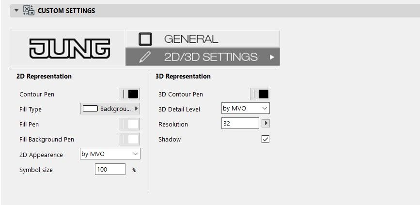

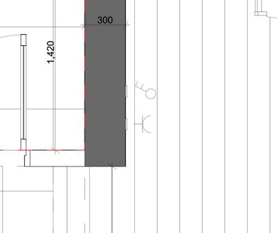

Hello! Does anyone know how to rotate the 2d symbols in Jung product library or is it just the way Jung intended? They are pointing the wrong way - towards the wall/switch. Mirroring does not work, no extra option in the custom settings.

It looks deliberate to me.

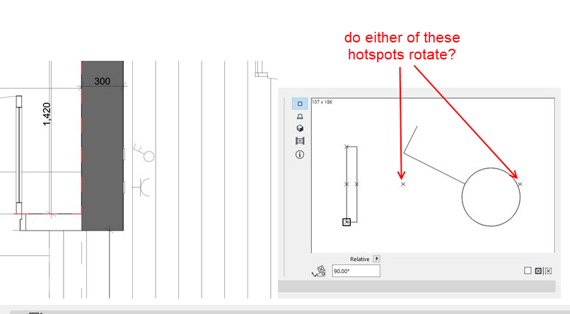

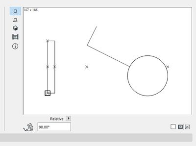

Do either of these hotspots rotate?
If not, then as it is a 3rd party object, you would have to contact the creator.

I would disconnect the symbol from the 3D element, but that's because generally the symbol is larger than the outlet / switch etc, so getting a readable floorplan output becomes very tricky.

It is complicated to modify the symbol part rotation because the object library is not editable in the GDL editor.
Anyway, even it is a manual workflow, you could turn the symbol off in 2D/3D SETTINGs> 2D Appearence and draw/place your own rotated symbol.
