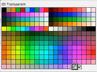

Make the background fill of the trees colour 0.
