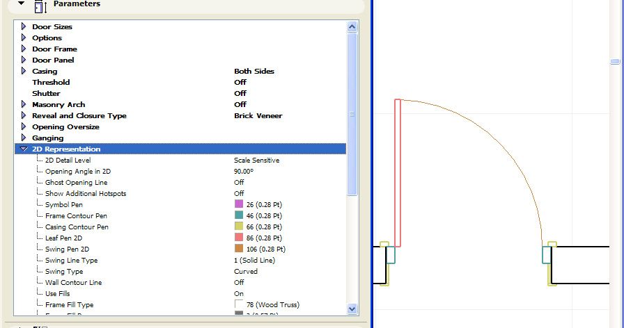

Eduardo Rolon
and I supposed that in this case I have to manually draw the sliding door opening symbol.

On another note, can somebody clarify what is the difference between the "Contour Pen" and "Pen in 3D". I thought that "Pen in 3D" was the equivalent of the "Uncut" Pen and Contour matched "Cut" but working with AC13 doors Contour only changes the floor plan cut and "Pen in 3D" is used for the door elevation and the section.

ejrolon wrote:
On another note, can somebody clarify what is the difference between the "Contour Pen" and "Pen in 3D". Contour only changes the floor plan cut and "Pen in 3D" is used for the door elevation and the section.
Yes, this is how it works, I thought it always worked this way, but I can be wrong. I often set the 3D pen much lighter so it doesn't overwhelm the section, elevation or 3D visualization.

Eduardo Rolon
Erika verifying, in AC12 and AC13
For Frames
contour = section and floor plan
Pen in 3D = elevation
For Door panels
contour = floor plan
Pen in 3D = elevation and section
If we substitute contour for cut it makes sense for the Frames but not for the Door panels and since in Walls, Slabs etc Pen in 3D means elevation not cut I think this might be a bug.

Erika Epstein
Eduardo,
In both AC12 & 13 I am seeing different pen settings for 2D and 3D. For both #d includes sections as well as the 3D window.
