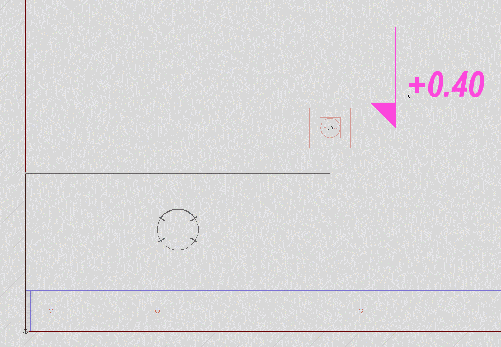

Why Dimentions are static in Int. Elevation?
Do you know why all kinds of Dimentions are static in Int. Elevation?
Every time I move an element in plan I have to go t each InteriorElevation view, delete the old Dimentions and make new ones!

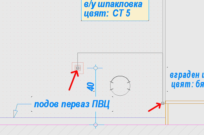

Here I post the result ov my work, which was why I started this thread! Thank you once again, guys! I would have given up wihthout your help!
