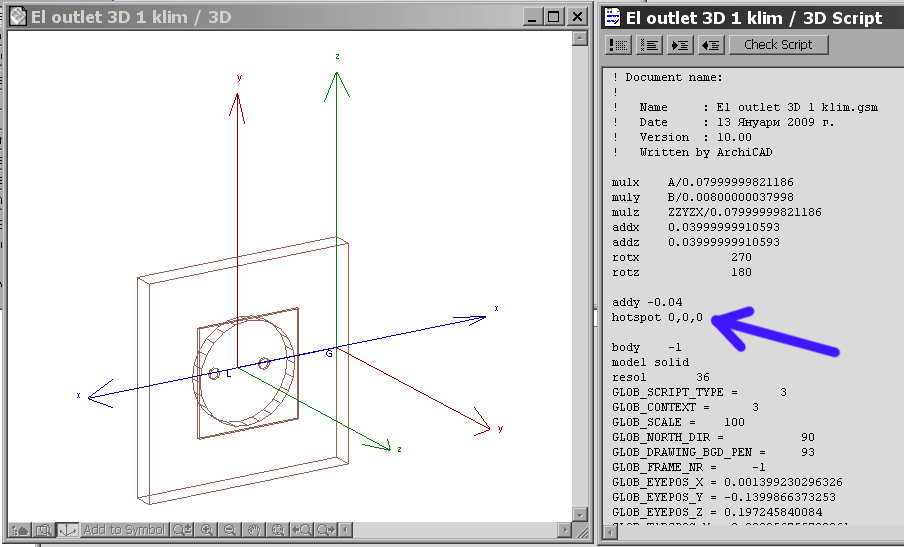

I suppose the problem is in the 3D hotspot! I have scripted one of the middle hotspots, but it is an ordinary hotspot without ID. It appears in Int. Elevation but dimentions read it only as static.
I could not understand how to manage the editable hotspots with their unID, paramReference and flags. Please, can someone help me with these? The hotspot I scripted is:
hotspot 0,0,0
and I need it to show the vertical position of the object.
Here is the 3D script of the object:

Simply, add (a comma and) a number after the tree parameters. That's all. I did a test with this very short script:
BLOCK a,b,zzyzx
HOTSPOT a*1/3, 0, zzyzx/2
HOTSPOT a*2/3, 0, zzyzx/2, 1000
and the image shows what I get when dimensioning.
If you have more than one HS in the SAME SCRIPT, use different numbers.

vistasp
Advanced hotspots confused the heck out of me at first but once I understood the basics I was a lot more comfortable.
When it comes to numbering them, it always better to declare a value and them increment them each time as in the 2D example below.
unID=1                                                ! always declare the first unID
HOTSPOT2 0,   ver, unID, hor,	1+128  : unID=unID+1  ! base
HOTSPOT2 -1,  ver, unID, hor,	3      : unID=unID+1  ! ref
HOTSPOT2 hor, ver, unID, hor,	2      : unID=unID+1  ! move horizontally
HOTSPOT2 hor, 0,   unID, ver,	1+128  : unID=unID+1  ! base
HOTSPOT2 hor, -1,  unID, ver,	3      : unID=unID+1  ! ref
HOTSPOT2 hor, ver, unID, ver,	2      : unID=unID+1  ! move vertically
