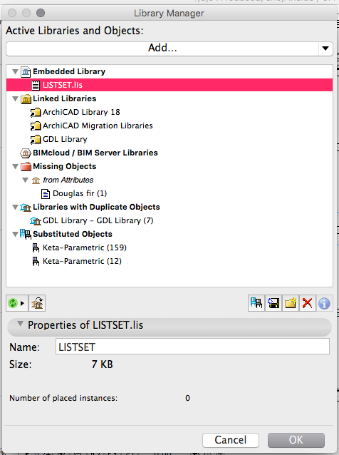

Hello :
I have a file containing a number of gsm objects, all with different names, although some names begin with the same word.
e.g object_first, object_second.
I assume these two file names are distinct and the second is not counted as duplicate.
Nevertheless, AC constantly reports there are duplicates.
How does one clear the decks and then import again from scratch. Merely deleting the folder in the library manager doesn't seem to work.

Hello :
"Save As" the gdl objects merely produces more duplicates. (Unless I'm saving the wrong items of course).
And there are now two substitute items for the same object as well. One of 159 and the other 12 items.
I’ve been working on the gdl files so clearly this is self-inflicted injury.
I’ve followed the instructions in the GUID helpfile. And I’ve found the GUID number for the object. However, I have no idea what to do with it.
I’ve searched for and selected the objects which are substituted and selected the correct object in the library. This makes no difference.
I’m at a complete loss to know how to proceed.

If this does not help at all, please send screenshots of the libray manager both embedded and external (see example)
Jochen Suehlo . AC12-29 . MAC OSX 14.4 . WIN11
Hello Suehlo san :
Thank you for your response.
My version of AC is 18.
1 In the object view, Embedded Library shows no files in the space below.
In Library Manager the only item in Embedded Library is ‘listset’.
2 I note your image “Archicad Library 21”.
If I choose “Archicad Library 18” there are only three folders Basic, Visualization and Addon. No foreigh files.
3 In my GDl Library saved outside of the AC folder, there are no files with identical names. However, there are files which were modified and saved from previous files. I guess this is the problem.
4 There are files that share part of a name.
e.g. ‘keta parametric’ and ‘keta with slope’. I guess this would not be a problem.

Try the following:
- click on "GDL Library - GDL library (7) and then the Info button: you will see the name of the doubles.
- open every double and save it under a new name: e.g. "block_1.gsm" instead of "block.gsm"
- remove the "old" doubles from the library (do not delete for security reasons, keep it as backup)
- reload the library and check if you have no doubles
- if so, you can rename the saved under a new name objects manually back in the Explorer: e.g. "block_1.gsm" to "block.gsm"
- reload libraries again.

OK done.
The substitutes have gone. However, there are still five duplicates reported.
Further, all those objects in the drawing which are no longer shown as substitutes are now assigned to another copy of the original gsl!
Yesterday I was experimenting with a copy of the parametric gsl and of course renamed it.
What I need to do is reassign the objects in the drawing to the correct version of the gsl file.
How is that done without doing more damage?
I've discovered how to reassign object in the drawing to the correct object file. That's done.
However, there are still five duplicate items.
Info show one item in the embedded library, a listset.
Info of GDL Library shows five items, each with a number of placed objects. No warning icon.
