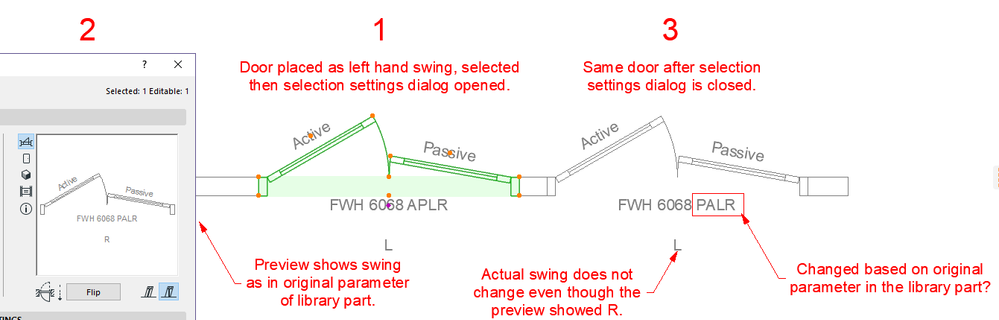

I saved a D2 door and added parameters and script to suit my needs. The 2d script is my own. The letter below the door is a text2 to show me the door swing (ac_openingside parameter) The issue I'm having is as follows:
1. Place door as a left hand swing. All is well.
2. Select door and open selection settings. As you can see in the pic the preview shows the door with an R for a right hand swing and it changes my text in the door name to represent a right hand swing door.
3. Close the settings dialog. The door on the right is a different door than the original but it represents what happens after closing the settings. Even though the preview showed the letter R, the original door swing (L) did not change. The only thing that did change is my text (2D scripted) to represent a right hand door.
Hopefully I have enough info here to explain what's happening.
Any thoughts on how to fix this would be greatly appreciated.
Thanks, Doug
