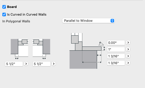

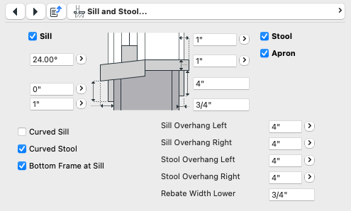

Hi, I'm looking to create a window with the Window 26 object in Archicad 26, but it seems to lack some options that the 24 Windows had. Mainly it's missing the option to include an apron/bottom casing underneath the interior sill/board/stool. Has anyone found a workaround? Considering just using the 24 windows but it'd be nice to be able to use the most up-to-date objects.
Screenshots attached of 24 window options vs 26 window options.
Screen Shot 2023-02-20 at 10.07.07 AM.pngScreen Shot 2023-02-20 at 10.07.57 AM.png

Are you using a different localisation of 26 than you were for 24?

Yes, just checked and I was using 24 USA, now using 26 INT. Would this make a difference?
Just installed 26 USA, didn't realize the library parts are different for each localization. Thank you!
