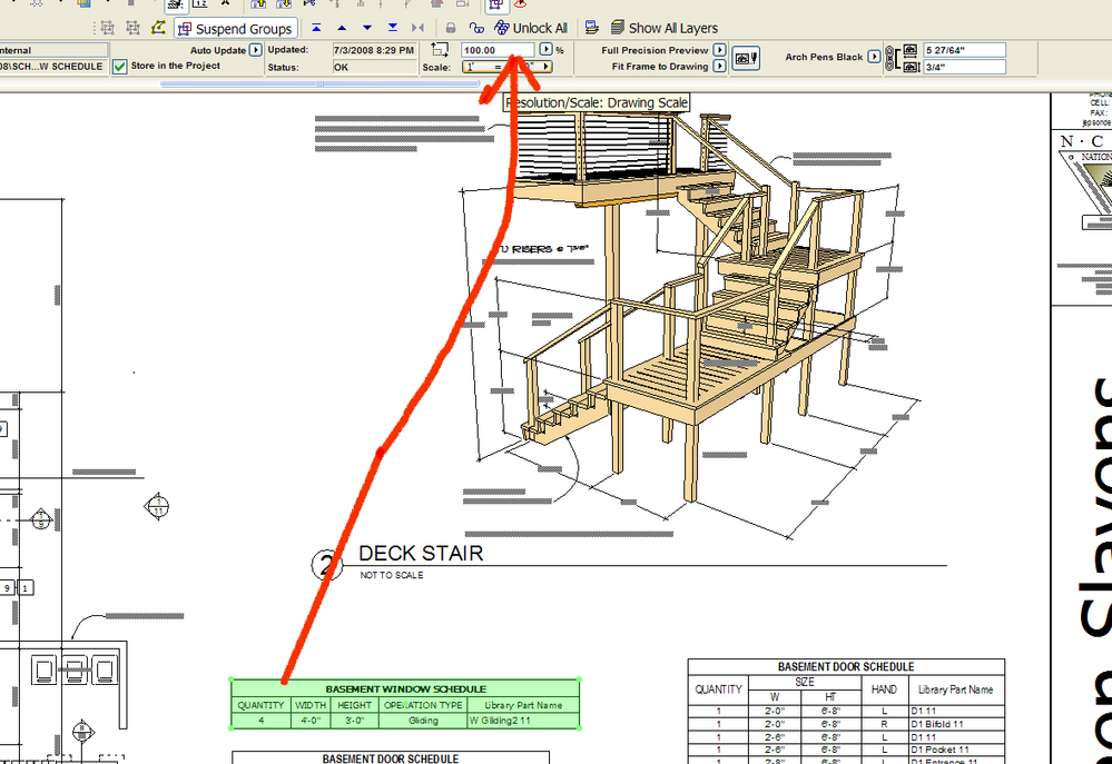

Window and door schedule scale on layout, says 1:1? Can you change this?

yes. You can also change the size of the text or the spacing in the schedule. When you place the schedule into a Layout you can change the scale there too.
