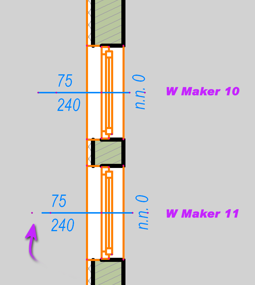

Both W Maker 11 and D Maker 11 have incorrectly defined hotspots. Hotspot 1, defined as "Maker position" does not appear at the end ot the centerline.
This makes selecton of the LibPart difficult as I have got used to selecting by clicking on the centerline.
There is not such a problem when W Maker 10 is used in AC11.
