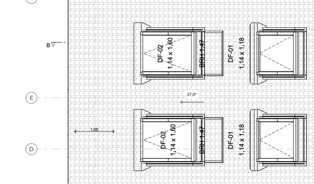

Hello,
I have roof windows that show on the plan the whole structureof the window - that I don't want to see (Bild 2) (the interior part of the window construction) .
When I copy the roof into a new ArchiCad file, it is displayed the way I want it. So I think, that it is a setting of the visual representation in ArchiCAD.
Since it is a large project, it would be complicated to copy everything to the new file. If anyone knows how to solve the problem, I would be grateful.
Bild 2: Existing view
Bild 1: Desired view

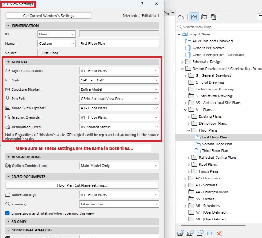

I assume you're using a template file of some sort?  Archicad template file or your own custom template file?  Hopefully both files were started from the same template file.  I would start by looking at the view settings from the drawing that you want to emulate and comparing it to the new view in the other file.  Make sure all the View Settings are the same.  If not then we need to look deeper into the problem.

Hi Jeff,
thanks for the reply!
I checked the settings and they are identical except for the layer combination, but I don't think the problem lays there.
Do you have any other suggestions on what to check?

I am comparing two files, and all MVO settings are the same. Also when I copy from one file to another it is showing not correct in the original and proper in the new file, so it can not be the 2d settings, which I also have checked and they are the same...
