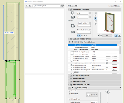

I have a bay window with a 40 cm board. The problem is that the board shows only when the window scale is set to 1:50 or I set the display to projected. I need it to be scale 1:100 (since i dont need that much detail) but also show the board. Is that possible? I saw somewhere that Ac12 could do that but i cant find out how. Thank you

In your window settings, is your 2D Detail Level set to full or by MVO? If by MVO, make sure it is set to full in floor plan view. Having both of those on should allow you to see the board.
