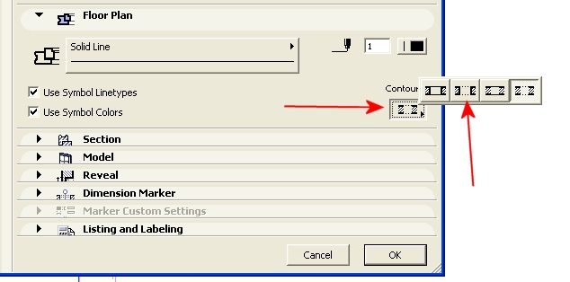

Stress wrote:yep, its been scince last week and still havnt shown. i dont know what 2 do, im reading the help, maybe ill get thru. and another thing, u know how u have windows in the wall, where the wall pen is .7 and the window pen is .1. i want to have the wall pen bordering the 2 short sides of the window and not the window pen colour diaplaying all around the 4 sides of the window. dont know if im explaining myself correctly. i need 2 know how to put in a picture so i can show it.

Wayn right
Try the contour button in the Floor Plan tab of your door / window settings.
