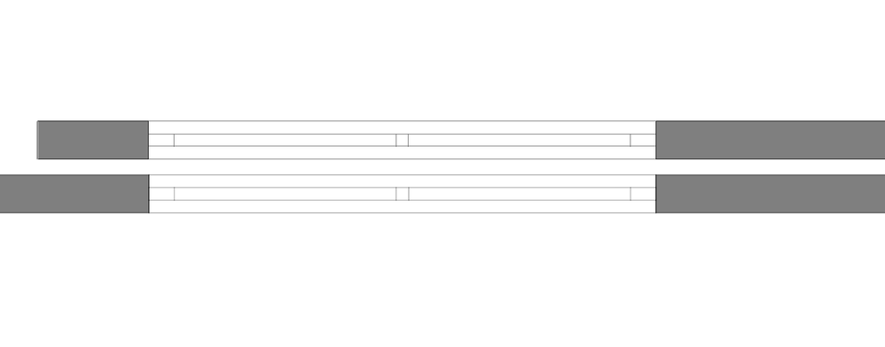

Window looks in different color
eneskaraca
I created a window style, to create new window I copy the window parameters from previous with alt click and insert the new wall. But here is the thing it changed the color. I move side by side the two window as you can see the original one (upper) is darker color but other has lighter black color. I checked all the color settings but they are same. I couldnt figure out can you help about that?
2 REPLIES 2
eneskaraca
I realize all objects has this color difference issue, I dont know how but I need the fix that urgently
Do they have different renovation status?
And then one of them is being overridden to a different colour?
Activate a renovation filter for "Show All" and see if they become the same.
If they do, then that is the problem.
