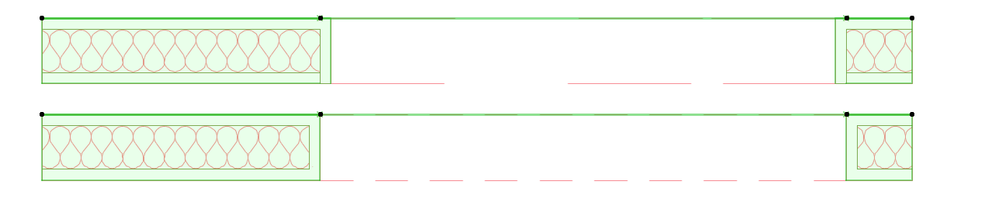

I'm trying to create interior openings (and sliding doors). I'm trying to make my doors 90 cm wide (the opening) and than I say I want to turn the plaster to make the wall ending on each side of the window correct but when I do so the door becomes 85 (2.5 cm of plaster on each side). Is there a way to make the plaster turn always outside the 90 cm I defined. I know I can make a door of 95 and than the openning would be correct but if I than use Listings the openings won't be correct.
In the image is the version bellow that I want to recreate:
