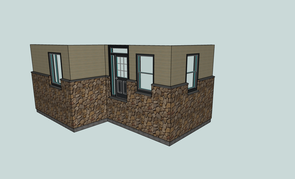

Could this also be modified to be used for brick or stone veneer with capping , cut at windows and doors , without having two walls running interference or using compound walls. ?

cutting out the windows situated in the Wall with such a the GDL will be the real challange.. and i see no direct way now.
What would be possible - to add prefabricated holes in every polygone - sequence - to turn on and off with a hotspot - and to drag to the exact position of the Window or Door in the wall.. with further hotspots.
This then would be another of my hotspotmonsters..

I've seen that in recent objects you have splitted each segment in two to alter heights. While I see the point for doing this (otherwise corners could be a problem), for the example posted by RandyC, I don't really see this need.
In that example, it is so easy to add and remove points using the base code that instead of having only 5 points for the corners of the walls (in red), you could add as many points as needed in between (in blue), provided the code allows for the manipulation of each segment's height individually. I think it would be easier to handle.
Keep up the great work!
