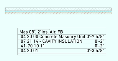

If you use the Skin List Label, rather than Autotext,
it is able to read the info from The Building Material ID section

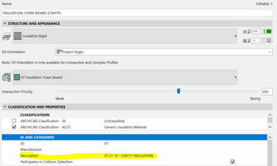

the "07 21 14 - Cavity Insulation" text is being pulled directly from the building Material Description under ID and Categories
If they would just unlock all this info for searching and adding under TEXT / AUTOTEXT and even in the basic Properties (Properties and Classifications) dialog...We could all make our labels start to read how we need them to, while still having a complete handle on the "I" in BIM.
sadly the I is rather hard to utilize, when so many properties can't be accessed with various tools at our disposal.
