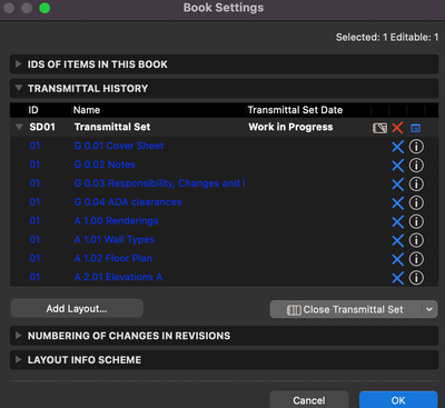

I have a gigantic list of changes that CAN´T be deletes because of some unknown reason.   We have the habit of copying solutions from file to file, placing hotlinks from other PLN or TW files.. and we allways end up with a gigantic list of changes that sometimes have a LOCKED symbol on it.. I would like to know how to PURGE all the changes from any file so we can start a fresh list whenever is necessary.

Eduardo Rolon
At the bottom of the last screenshot there should be a button for 'Transmittals" can you post a screenshot of it to see if it is empty or not.
It should be empty or at most only one "Transmittal Set" and it should have the date as "Work in Progress".
If it is not empty can you delete all the sets?
Also, which version of AC are you using?

BGrasselli
Hi Eduardo,
I do have this Transmittal set as Empty, but most of my changes are still locked. In other files, that i had an Issued Transmittal I tried opening the last set, deleting it and still the problem persists
I am using AC24
