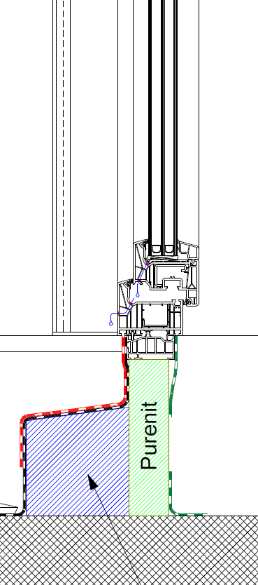

I need  some help. I am working in project where we have doors/windows opening in terraces and balcony.
Windows objects and doors aren't correct in section.
I don't know if it is possible to get a result like the picture (not as detailled but at least with right ccompenents )
thanks

It wouldn’t be part of the window/door itself but you could set the window/door with an enlarged opening and then use a complex profile applied to a beam to create what you see in your detail.

I will give it a shoot.
