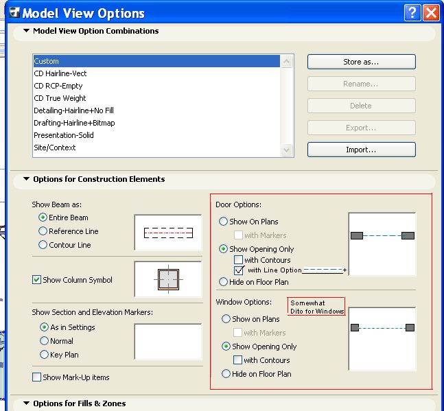

New "core-only" may be great, (We'll soon see), but...
What I'd like to see is a MVO option that shows,(by line type) (see modified MVO below),whether the opening is a window or door, as requested by my current structural engineer. Better yet, how about additional option for showing what type of bearing capacity, by showing option for, say; double 2x's, 4x's, 6X's etc. on either side of opening?
Maybe my brain is not working, but why would it matter what kind of opening you have (window or door) when determining structural elements? Isn't an opening an opening?
If you are sending dwg files to your engineer, you can let him sort out your request. In the dwg translator, under Attributes > Layers > Methods, you can choose to have Window linework placed in a specific layer and door linework placed in a different layer. The engineer (or you if you have autocad) can then make each of those layers use a specific line type.

Hi Karl
Thanks for your thoughtful comments.
First, my structural engineer gives me a break on pricing if I do the red-line corrections myself, including the details he may add, because he is not a fan of being on computers as much as some of us are.
So, that being said, he prefers to red-line printed sheets.
Also because, he's a practicing General Contractor, who really gets how things are built in the field, I wouldn't even think about using anyone else.
Plus I stopped using autocad myself at v9. (1989).
About the doors vs windows, it does make a difference here in earthquake county.
Many windows ,if not too large,can be made to be "mitigated" openings.
With correct blocking and strapping the sheer value of a windowed wall can be used as continuous, Not so with a door.
Also what type of connection member you use at sheer panel joints or at the end of a sheer panel call out matters. 2x's have to be calculated by the nails that hold them together,
whereas 4x's do not and are much prefered.
Hope that helps explain it.
Bier
Thanks for the education! 🙂 I assume it is the fixed windows that provide the additional shear value?
Nothing directly in 12 to help identify the window openings. (If there was a model view option that would allow window labels to be visible even when the window was represented only by opening lines, that would be perhaps an OK workaround - but not possible.)
Cheers,
Karl
Well. Show Windows with contour and Doors without.
Karl
