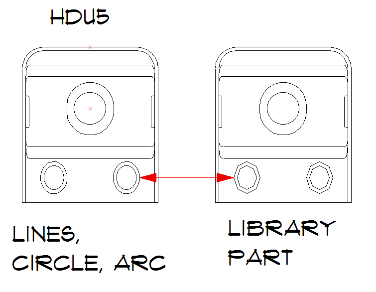

What can I do to increase the arc resolution of my library parts.
It looks fine in 2D plan view but changes when I make it into a library part.

Steve:
If the symbol is created in the 2D Script, then check the RESOL setting (page 153 of the AC11 GDL Reference Guide).
