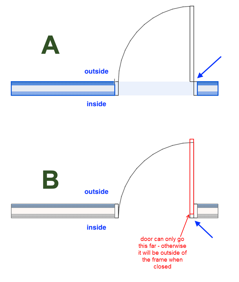

change position of door but keep door frame equal to wall thickness
Hello everyone, I am trying to go from what I am showing in "A" to "B". I have managed to achieve this but without having the door frame thickness the same as the wall thickness (which I would like to have). Is this possible in Archicad 26? Thank you in advance!

Can you please explain what you are wanting a bit more? Between your description and images I still have no clue what you are trying to do...

I would like the door to be along the inside of the wall (as in B). I hope this helps.

That door will smash into the frame when you open it and will sit outside of the frame when you close it.
And where is the door stop?
I am not quite sure how it would work.
The door can only physically go this far, and even and even then it has the same problems as mentioned above.
Oddly though, you can adjust the leaf position in 3D, but it does not affect the 2D plan.

Thank you so much for explaining it to me! You're right about the door going that far. Now I know that I can't represent that in 2D. Thanks again!
