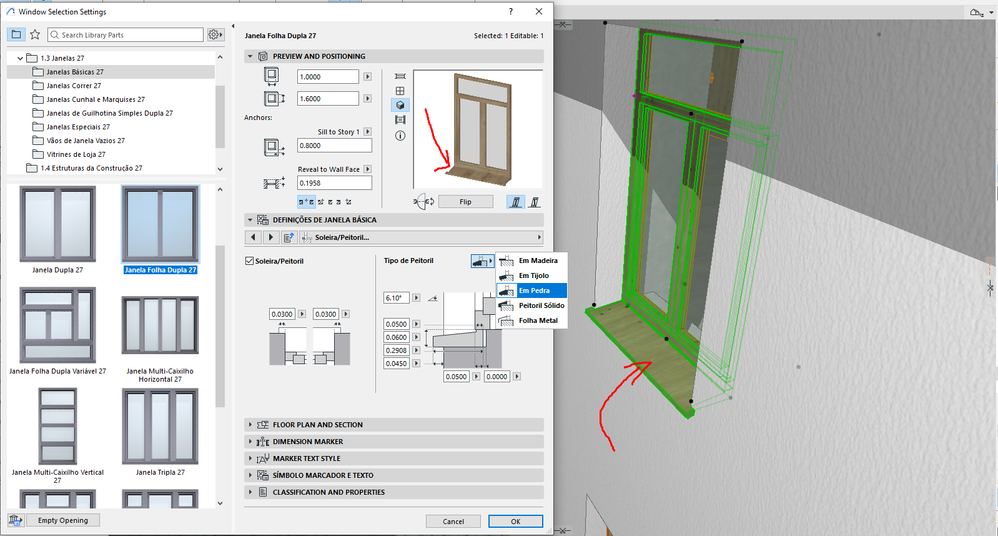

Can someone tell me how do i go about changing the material of a window sill? In my option i already chose "stone" (pedra), but i need to update its view and material to stone. How can i do that?

You can find it (Sill Surface) in the model attributes sub-menu. You can assign it there.
