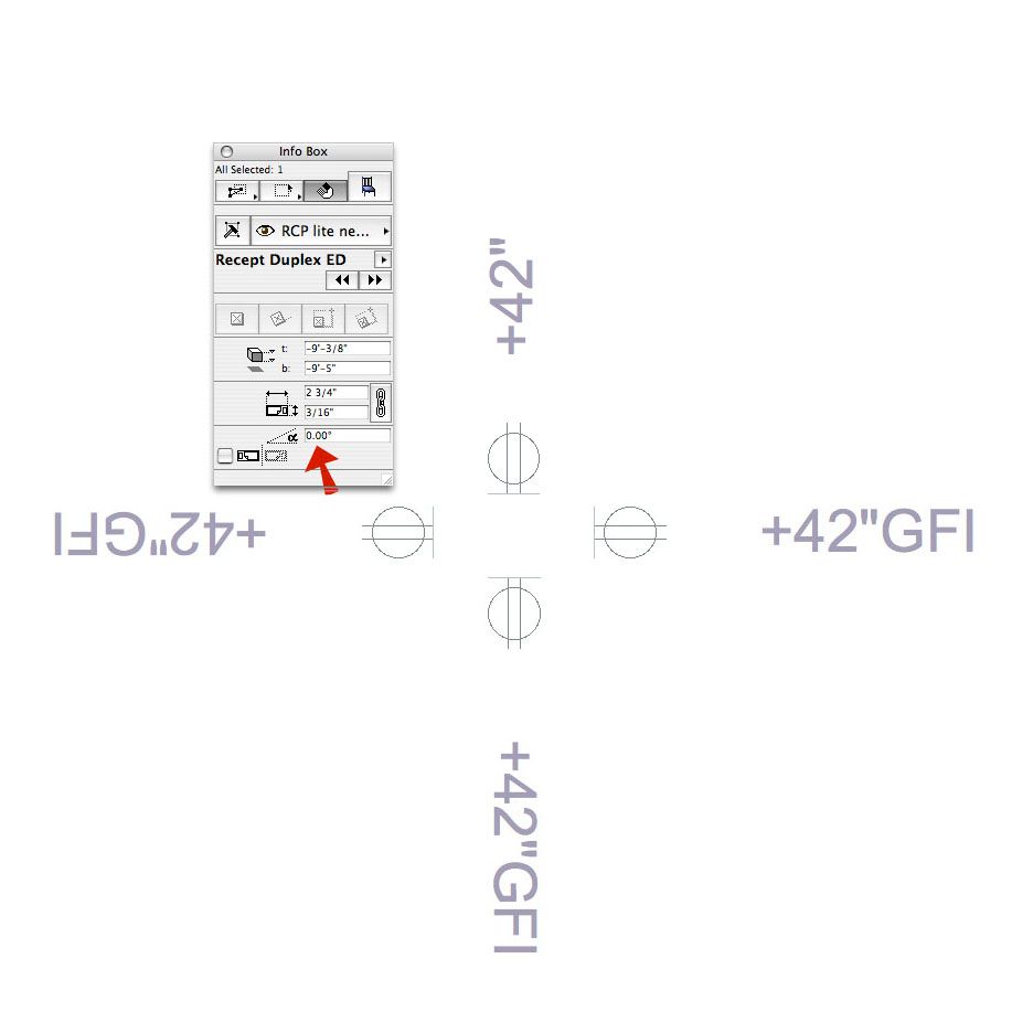

I'm working on a duplex receptacle part that uses the object ID to add text to indicate mounting height and other information. I've got the ID request working, but I need to know how to do 2 things:
1. Change the rotation of the text so it reads from the bottom of the page when the object rotation is >0. I assume I can use ><= with a range if numbers in an IF/THEN, arrangement to add some rotation adjustment around the anchor point, but if anyone knows a better way, please let me know.
2. How to properly make use of the stw string function. My txt_adj isn't coming up with the proper amount - see the attached screenshot. Per the code:
Define Style txt "Arial", txt_sz, 5, 0
txt_adj=.5*STW(mkr_ID)/1000*A_
Pen txt_pen
ADD2 0, 12"+txt_adj !!!!12" moves the origin to the outside of the receptacle
Style txt
rot2 90
Text2 0, 0, mkr_id
Shouldn't 1/2 the stw put the origin of the text in the proper spot so that when the text is entered, the edge of the text reaches back to the 12" mark? It appears to be starting the text left justified as is I was using 4 instead of 5 for my anchor point.

Frank Beister
Without testing it, but the DEFINE defines the style. The STYLE sets the style. If you want to measure the text, you have to set the style before!
DEFINE Style txt "Arial", txt_sz, 5, 0
SEt STYLE txt
Pen txt_pen
rot2 90
Text2 0, 0, mkr_id

so how does this work? check script gives me "txtA isn't a valid parameter name". Do I have to define those variables somewhere first?
Frank Beister
They have to be part of the parameter list. They are the coordinates of the text.

OK! made some progress!
I have the part working with fixed text from the proper origin, or with the movable hotspot starting at 0,0, but I can't get the code above to move the default origin and then let the user modify the hotspot. The spot is green as if the program would let me move it, but the pet pallette does not give me the option.
Any thoughts? Thanks for the help so far!
Wes
